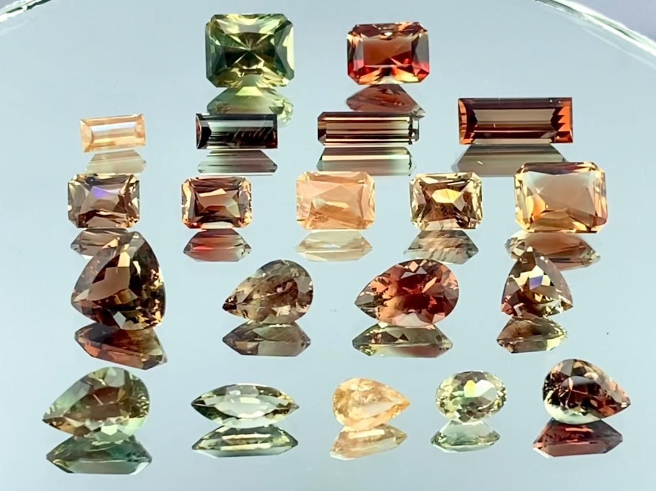

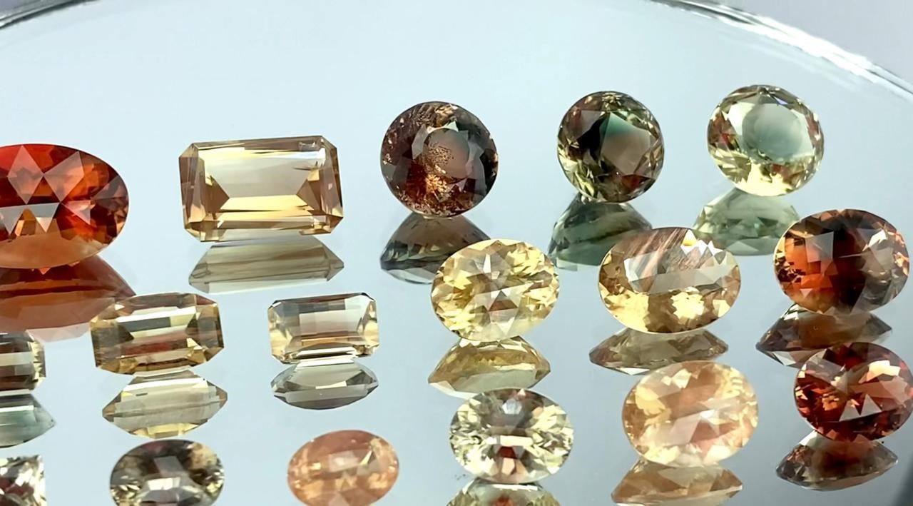

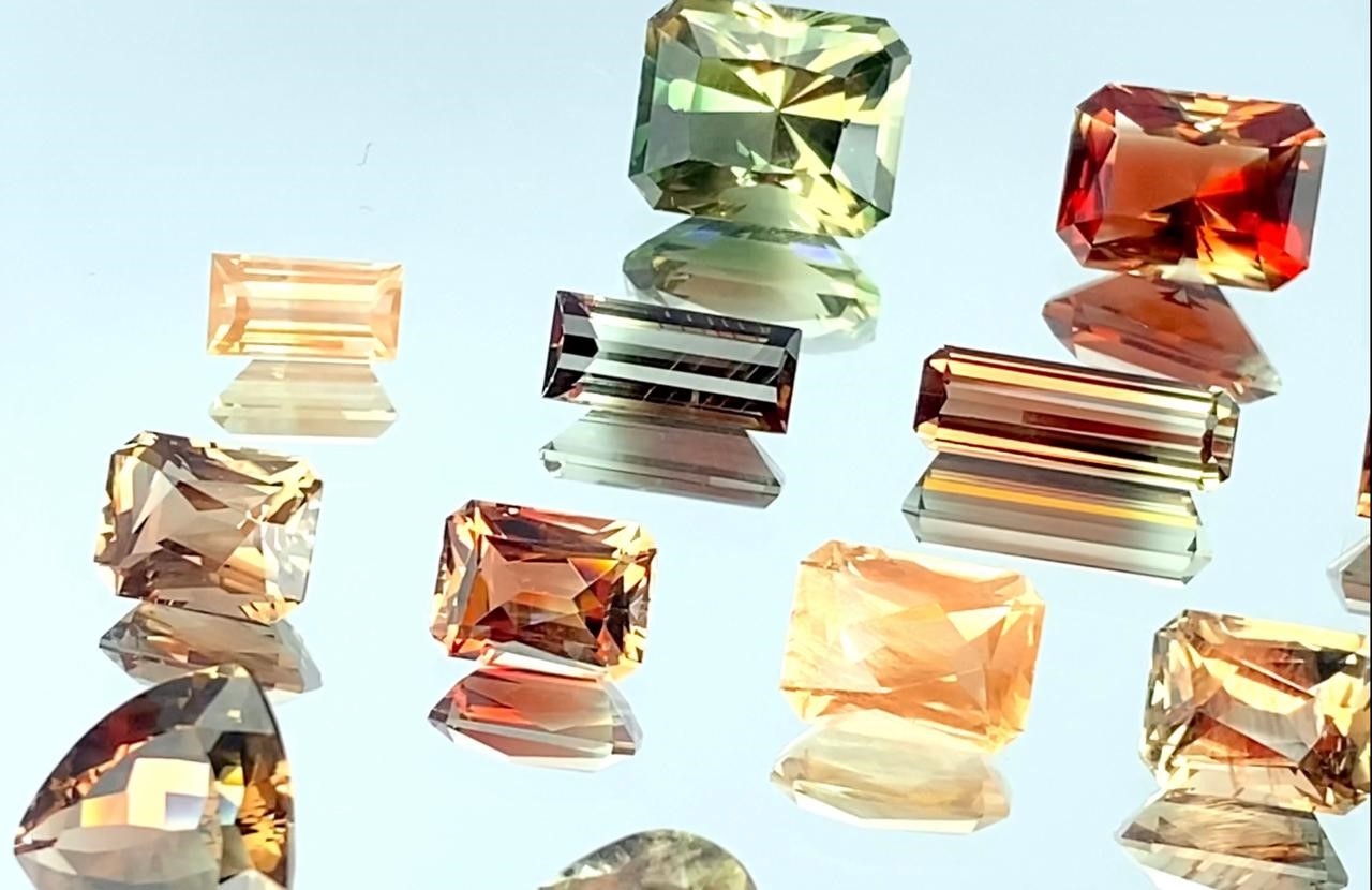

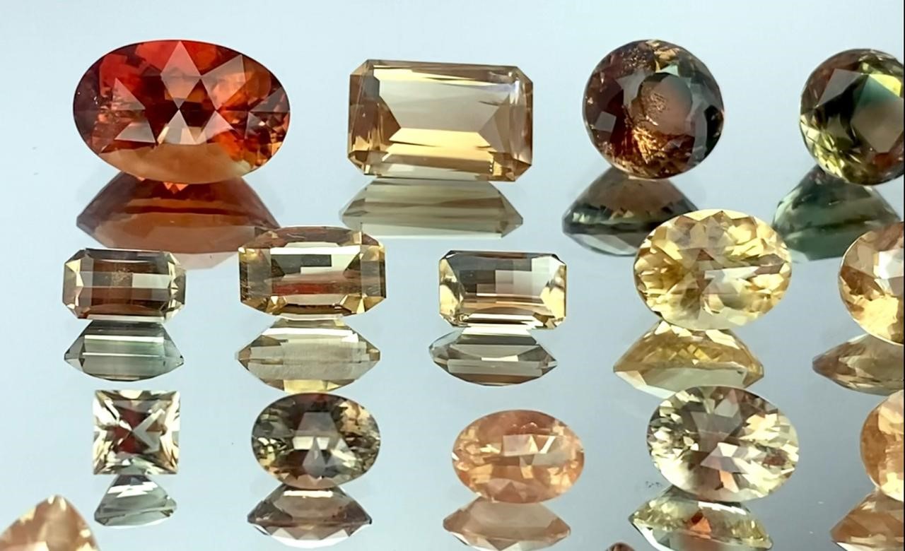

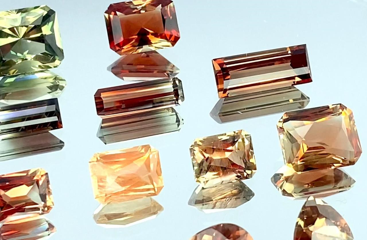

Final Results
With the polishing and quality control complete, the sunstones are now beautiful, high-quality gemstones, ready for use in jewelry or as collectibles.
